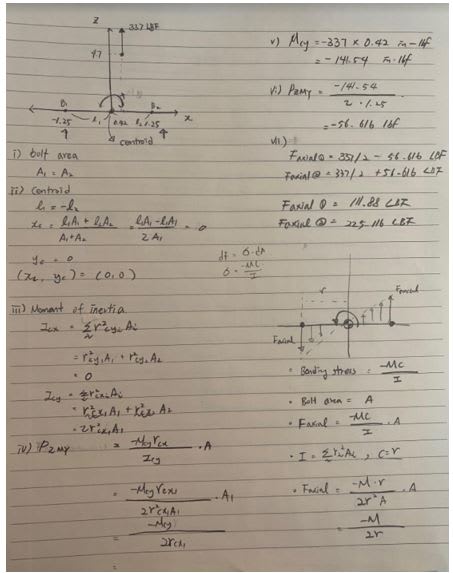

Hello rb1957
I have calculated bolt group as below.
