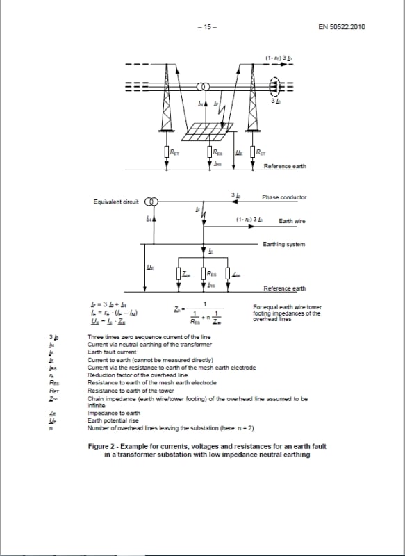

In low voltage circuit, the current to ground can't be bigger than Uphase/Rground, or Uline/sqrt(3)/Rground.
I assumed that your Uphase was 0.217 kV as the figure you sent, really is is 0.400/sqrt(3)= 231 V.
Rground is the resistance to ground of your grid1 electrode.
The SC current in 20kV side is 500/20/sqrt(3)= 14.43 kA.
The Uphase is 20/sqrt(3)= 11.55 kV
The current to ground can't be bigger than 11.55/Rground
A fraction of the fault current returns to the source by neutrals, the rest is really injected to ground.
The Standards (as VDE and EN50522) explains in the figure the paths of the fault current.

More transformers, more fault current, but current to ground are no increased, because the bigger fraction of current returns via neutral to the transformers.
In some cases the neutrals of transformers can be disconnected, with only one connected all the time. This is to reduce the fault current by busbars, etc., not the current to ground.
