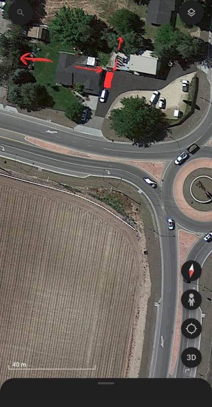

Hopefully, this is the right place to answer my questions. I recently picked up a motorcycle dyno that is placed in a metal shipping container where one side and back doors open while in use. Long story short I've gotten a few complaints about it and want to try and understand what my neighbors are hearing and coming up with a plan of attack to remedy the issue.
For all intents and purposes, we are talking about a Harley Davidson producing 115db at around the 50Hz mark and up.
I'm about 45ft from my closest property line and the other is 140ft (this is the neighbor that has been complaining). I dont expect my results to be silent but to slide a little more under the radar. We are by a busy street that creates 85-90db (measured at the road) pretty consistently and even has big trucks going by with their jack brakes on.

Thanks for the response. Yeah it's not ideal for sure. Above is a picture of my lot and location of the container. The neighbor that is complaining is to my left in the image. My house sits between me and them as well as a row trees at the property line.
I'm curious what the sound would be like if it wasn't in the container.
The muffler I attached in my first post would site out side the dyno and direct the sound up as well as hopefully reduce it by 15-20db. Then I would be left with more or less the mechanical noise of the motor and dyno.

That design would not be especially effective at low frequencies. You really need an expansion chamber like a truck muffler or the one you linked to. Now, assuming these bikes are running fairly minimal exhausts you also have a high frequency problem so the rifle silencer would help. Unfortunately without knowing which frequencies are upsetting your neighbor it is a bit hard to be specific.
