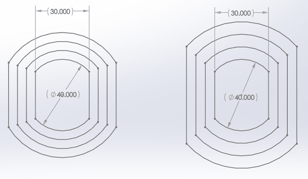

Hello All
Please ref to the snap shot below, this is from Y14.5-2018 Figure 11-35, I'm interested to know what will be the differences by removing the Dynamic Profile Modifier from the lower segment.
Thanks in advance
Season

Case b) and picture on the left are clearly about offset, so is ISO OZ modifier mentioned by pmarc.
The interpretation by Geotol referenced by greenimi mentions changing "size" while maintaining "form", which is more like picture on the right.
So, naturally, I am asking if anywhere in ASME there is clear definition of what "progression" is.

When the dynamic tolerance modifier is applied to a lower segment of a composite tolerance without datum feature references, the tolerance zone controls the form but not the size of the feature and it uniformly progresses (expands or contracts) normal to the true profile, UOS.
I think the inclusion of the term "size" in their description communicates the intent to allow progression (expansion/contraction) of the tolerance zone but is maybe misleading as it conflates the meaning of size with the established definition for FOS. Its probably best then to ignore this and focus instead on the portion describing uniform progression normal to the true profile as well as the examples and figures shown. Unless presented with significant evidence and reasoning to the contrary, I would expect the behavior to be almost identical to the ISO concept of OZ that pmarc showed.

It looks like "offset" interpretation has a merit. I guess I just leave it right there.

I agree that dynamic profile involves consistent offsets from the true profile, not maintaining the original aspect ratio of the feature. It's offsetting/progressing, not scaling. I also agree with pylfrm's description that dynamic profile is like a generalization of total runout - that is a good way to describe it. If no datum features are referenced, then dynamic profile becomes a general form control. Another way to describe dynamic profile is that it is like unequally disposed profile, with the amount of unequal disposition (value after the (U) being variable instead of fixed.
The next version of Y14.5.1 is not published yet - I'm hoping for first quarter 2020. There will not be any coverage of dynamic profile, as it was not in Y14.5-2009.
Evan Janeshewski
Regarding "progressing" (which I would prefer be called "Normal expansion or contraction" in the standard) vs. scaling, with the dynamic profile modifier, I think the best way to describe why the tolerance zone boundaries are both a normal expansion or contraction from true profile, with the distance between the boundaries fixed at the specified tolerance value, is that this is the same way normal profile tolerance zone boundaries are defined.
Scaling is not ever used for profile tolerance zone boundaries, but for simple features like cylinders and slots scaling would yield the same result as normal expansion/contraction.
