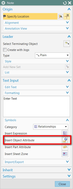

It is possible.
You basically do it the same as in Drafting.
Place a Note pointing to an Object Attribute. To be able to do this you first need to add this attribute to your View (Right Click - Properties)
