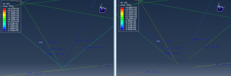

Sorry if I was not clear but my question is if a given joint`s stiffness has to be included in the global model?
I cannot use submodel as i have beam model(and it is not my goal nor my question). I am trying to solve the global model with beams and apply SF and SM values on local model.
If you look athe image below you can see two types of the global model. One where the full length of the connected profiles (as beams) modelled with kinematic coupling connected at the ends. On the other side where the local part of the joint is hidden(modelled with shell and connector elementes). This i often cannot see or did not find any documentation, examples that the stiffness of a joint is always included that way. Question is why? if it has some difference in SF values as you can see on the picture.
All right, so you are talking about analyses without the use of submodeling technique but with manual division into global and local model.
It might depend on the type of structure. If it's large and with lots of such joints (like a transmission tower) then you won't be able to account for their effect on the entire structure anyway. But if it's small and has a few joints the stiffnesses of which may influence the global response then such a detailed modeling approach might be a good idea. Still, I don't think it's very common.
