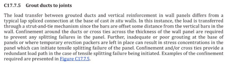

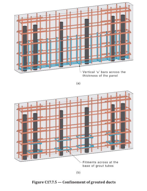

Worth noting that the commentary now clarifies, at least partially, what the detail would look like. My understanding is the detail can be achieved by usign closed ties (as we have discussed in the old thread and as specified in the NZ commission guide) or by using U-bars,as per below image. Unfortuntely, there's no clarification on how to calculate teh required area of these U-bars or closed ties. I htink I'll keep using the rule in teh NZ document.
The vertical ubar detail doesn't really provide any confinement at all to the duct and the bars lapping with the duct, I wonder what the justification was for suggesting the details were equivalent?
NZ detail effectively requires the confinement over the full length of the connection (and provides an equation to evaluate the required closed tie diameter), not just as implied 'at the base', hopefully that requirement is quantified?
Agree with you, Agent666.
Reading the commentray clause (also attached below) I am inclined to think that these detailes are not equivalent, they do different things and one should not substitute the other one and they should be both used at the same time. Not very clear on this though, first uses the word OR, then usses OR/AND... quite confusing. So I exepct almost every engineer in Australia to just use the U-bar detail as it will be cheaper and easier.
The way I read it is that AS3600 is not trying to provide confinement to the full length of duct. It is providing reinforcement at the base of the panel for a splitting failure, which both details will provide.
I find the comment about the erection packers interesting. In my experience they are always left in place. I do not see how they can be safely removed.
But the transfer of load (i.e. the 3D strut and tie mechanism they refer to) occurs over the full length of the lap/duct. I don't disagree with the splitting is likely to initiate at the base where the stresses are higher, but just providing the reinforcement at the highest stress points may not cover the same splitting occurring further up the panel.
