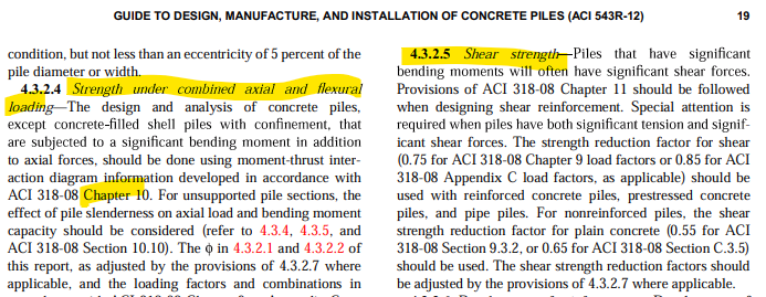

1) Have a drilled pier subjected to shear, should the minimum shear reinforcement be provided per ACI chapter when Vu > 0.5 phi Vc? Or should this be just treated like a foundation and just make sure that Vc > Vu and move on without checking the minimum shear reinforcement requirement. I could not find any document for the drilled pier design which mentions shear check.
2) If shear reinforcement is provided with circular ties, can one tie contribute to two legs of reinforcement like shown below?

Yes, one tie contributes to two legs. Similar to a circular column. You would use effective depth as 0.8 times diameter.
You can review ACI 336.3R or ACI 543R-12.
