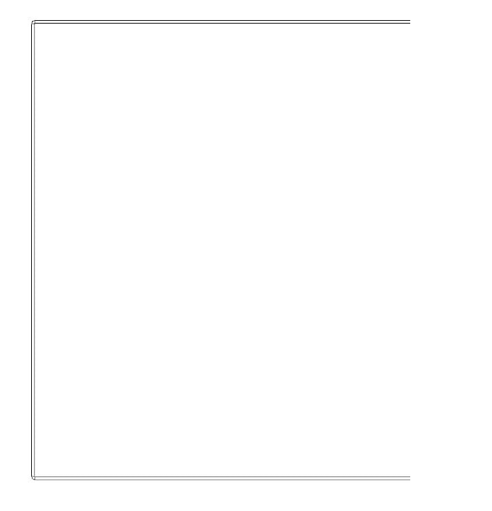

Hello,
I am trying to find a way by using the drawing boundary (manual rectangle) to make a drawing view smaller. Adjusting the rectangle works to cut-off parts that are outside of my intended view. Is there a way to show intersected edges, such as the red line I drew below?
Thank you!
Keith

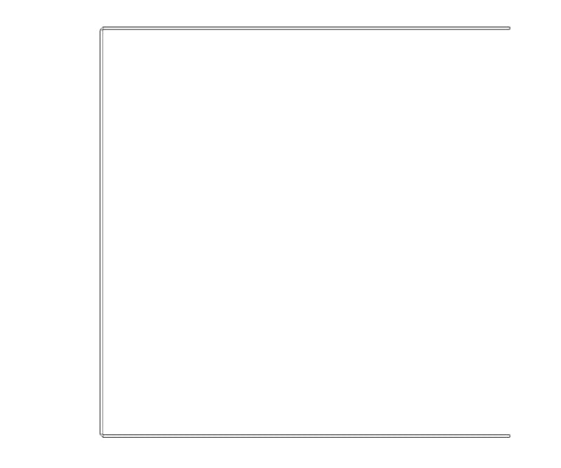

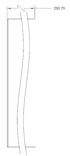

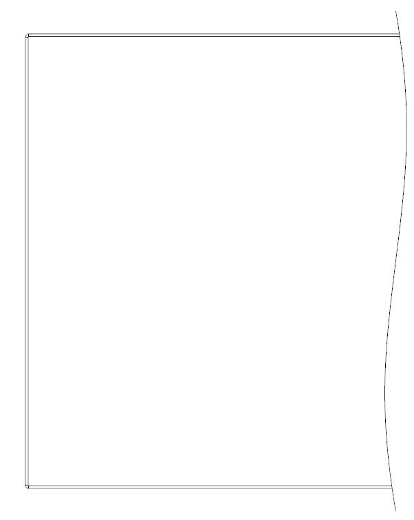

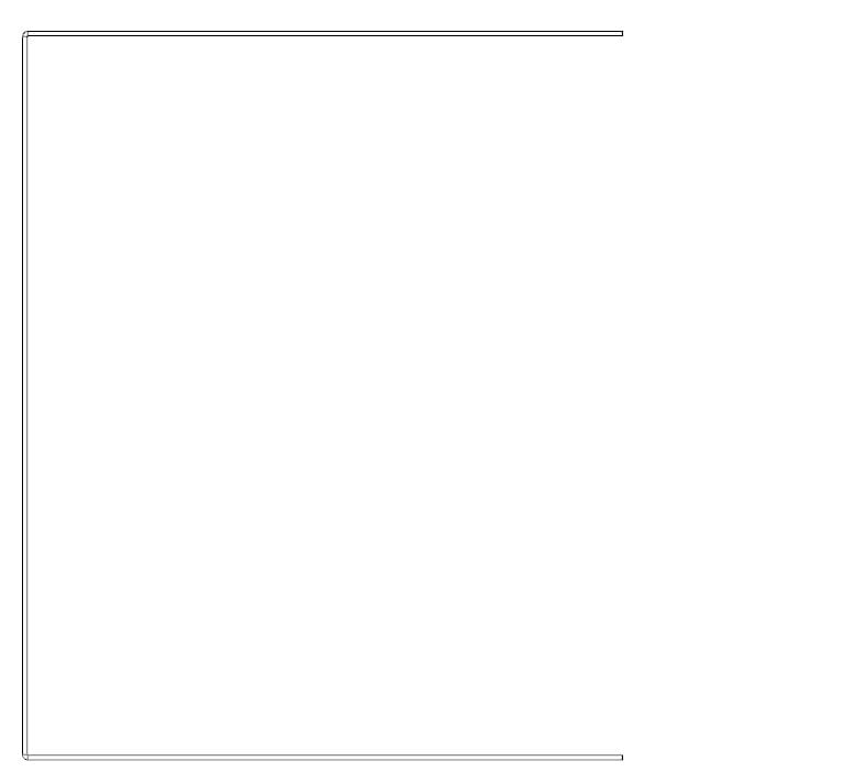

Hi Cowski,
A view break does work in this application, and is currently what I am using. I am trying to re-create a feature a previous CAD system had, which would draw these part-boundary intersection sketch lines automatically. Hopefully these pictures explain what I am trying to do.
Original part:
Single-sided view break:
Manual rectangle boundary that is smaller than part:
Manually drawn lines at part-boundary intersection:
Is there a way to get the last step by enabling an option?
One could argue that the proper way is a regular view break, as shown below, but this is not the legacy feature I am trying to re-create.

There is no option that I know of to get exactly what you want. If this is part of an existing drafting standard, you should contact GTAC so they can implement it; they give greater weight to existing drafting standards when adding functionality. However, since your procedure will essentially create a "not to scale" view without any indication to the reader, I suspect it is a non-standard practice...

I think that you want a line where the view boundary cuts off the model contour, and no, NX will not create that automatically.
You can draw that line yourself, either having the view or the sheet as the active sketch view. If its drawn on the sheet, it will not follow if you move the view.
if its drawn "in" the view, it will follow if the view is moved but you will have to draw the line slightly -slightly inside that border, else it will not be visible.

Btw, a detail view will do "partly" what you are looking for, the boundary will be visible and the contour stops at that boundary.
