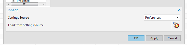

i created a drawing template, set all standards such as hide border, extension line gap, hidden lines visible in dotted lines and saved it as template, edited .pax file. now when i start drawing in that template, these standards are not visible in drawing. Border lines show up, no space between extension line and object etc. Even drafting standard also set accordingly, but still every time i have to do those changes manually. Is there method to get these standards automatically or am i doing anything wrong?
do you have below setting in your Drafting Preferences?
If the Settings Source is set to Customer Defaults, it will always take the settings from there and not from Drafting Preferences.

Are u talking about this? am using nx 11. if yes, its drawing template, so it should still work fine as i set both drawing template and drawing standard same.
Hi Ignx, I have the same problem. Did you get a solution?
