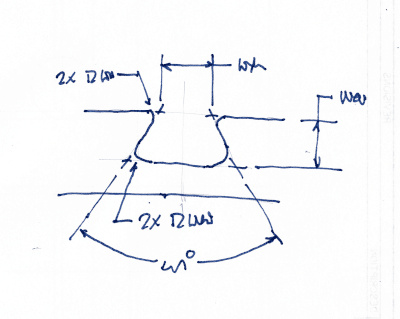

Hi all,
I have a plate that has a dovetail groove cut into it for a gasket. Link below to a somewhat similar dovetail groove to get my point across.
Link
Keep in mind this dovetail groove is a tool path around the entire perimeter of the plate and not just a local feature.
So my issue is that, someone gave the major diameter of the dovetail a positional tolerance and made it a datum feature. Also, they controlled the neck diameter of the groove with a positional tolerance back to the datum feature established by the major diameter of the dovetail.
I feel like this isn't correct. Would you all agree? The dovetail groove is not a true feature of size (locally it is) since it routes around the entire perimeter of the part.
I guess I was thinking a profile tolerance could take care of the entire grove back to the main datum reference frame. Or maybe even a profile tolerance with additional MMC positional tolerance (like Fig 8-24 Y14.5-2009)..but that may be overkill.
Any suggestions?
Thank you
By "major diameter" you mean the distance between the bottom radii of the groove (produced by the major diameter of the milling cutter), correct?
dthom0425,
Its certainly possible to utilize directly toleranced dimensions attached to either the dovetail itself or gauge balls/cylinders to define a dovetail. Attaching a position tolerance to the "neck" or "major diameter" as you call them - I assume these are both dimensions tangent to either the radii at the top/bottom of the groove or the sharp edges if no radii are present - are troublesome as these are not stable features from which one can establish a repeatable UAME. Also if its what I'm thinking the "major diameter" exists inside the material - not impossible but it makes it harder to verify, it would be more common to use gauge balls/cylinders for this dimension instead. MMC position might provide a workaround to utilizing position though.
That said, there are ways to dimension a dovetail unambiguously with profile. See the attached, it can be modified with composite/multiple single segment if desired for refinement.

dthom0425,
From a dimensioning and tolerancing point of view, that is a nasty shape. Your drawing is for the cutter. This is not how you would dimension the slot in your drawing of the plate. Do not specify tools. Your tool could make two passes to get the correct slot width.
This is a better way to describe your slot, especially if you are applying GD&T controls. I am assuming that you are using the flat faces, not the radii.

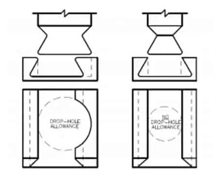

Milling of a slot of this shape even when it's passing through, requires roughing with a regular endmill before the less rigid form tool machines the undercut.
