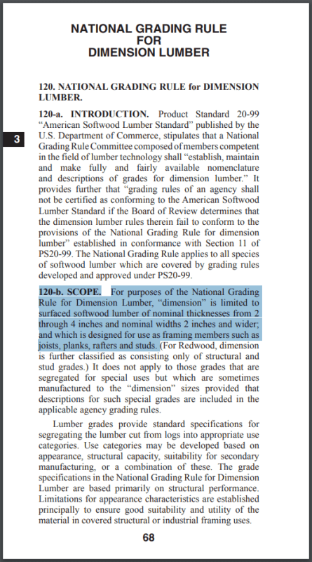

Hi everyone,
I have an old as-built drawing that shows the bending stresses, but it is worded differently than how it is worded now so if anyone can chime in based on his or her experience, it would be much appreciated. See the attached image for your reference.
In today's standard per NDS, the bending stress values are different between Visually Graded Dimension Lumber 2"-4" and Visually Graded Timbers Beams and Stringers (5"x5").
So will the 4x14 DF purlins @ 8'-0" oc in the roof fall under 1300 psi as "Beams" or 1500 psi as "Joists" because it is 4" wide?
Is there any online resource that clarifies this? I will not take a chance on this so I am inclined to using more conservative value but what are your thoughts?

I'd have to check my 1963 design book but I feel anything 4" wide qualified as a beam. joists were limited to 2" wide. It has to do with the uncertainty in the thicker lumber that there isn't an imperfection in the section somewhere.
The 1962 NDS defined a beam as: "Lumber of rectangular cross section, 5 or more inches thick and 8 or more inches wide"
My experience is the same as Wallache.
I tend to find some extra capacity in the girders, but not the purlins (4X14) or sub purlins (2X4)
Can confirm it is 5" and thicker for beams. so 4" would be considered a rafter, joist or plate.

Agree with everyone above...4x would be 1500 psi. For reference, take a look at the WCLIB Grading Rules (excerpt below). The most recent edition can be found here: Link. The USDA Wood Handbook is also a great source for investigating these types of questions: Link.

So 1300 psi gives me 97% stress in bending, which leads me to believe that 1300 psi was used. With 1500 psi, demand capacity ratio (DCR) is 85%. As a side note, no issue in shear.
