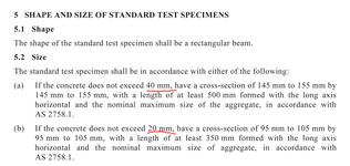

Does anyone understand the meaning of 40mm and 20mm in this snap of AS 1012?

Does they mean slump test?
I assume it is max aggregate size, but it is very poorly worded
