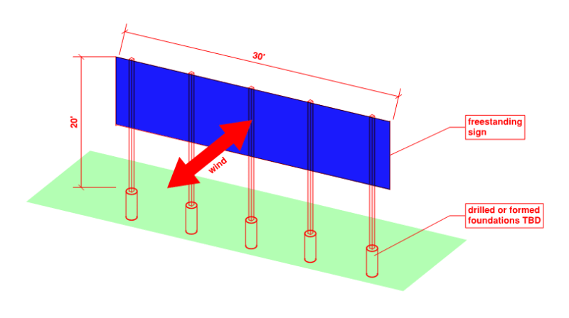

I'm wondering if the sign structure below is worthy of getting a geotechnical report or if presumptive values in the code (US) are good enough.
I guess it's more of a "what will the plan reviewer say" type question, because from a design standpoint I can just make it work with the low bearing/lateral capacities with bigger footings.
For us it is usually a question of how big are our footings getting relative to using minimal code/assumed soil parameters - vs. the cost savings (possibly) of getting a geotech to take a boring and give you a report.

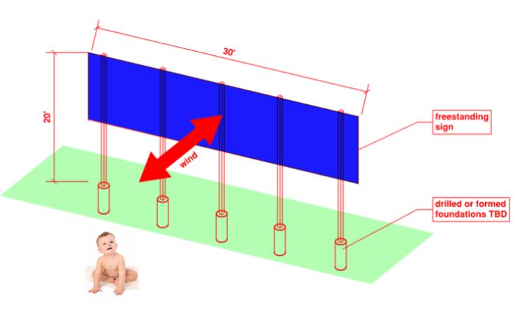

Even with this condition? :)

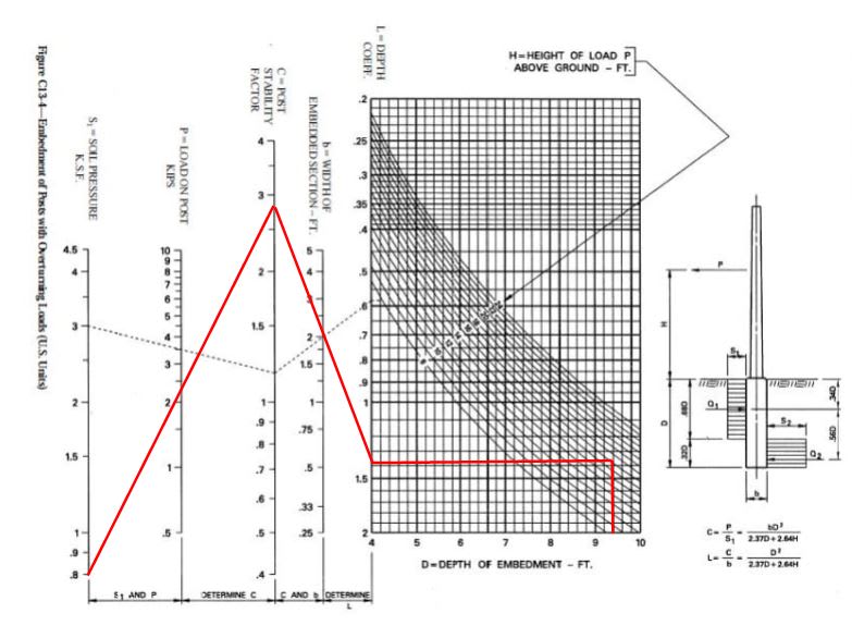

The AASHTO Standard Specifications for Highway Signs etc. has a very useful design nomograph for lightly loaded signs. This might be useful for your sign.
I think there are older free versions of this specification online. Section 13 is the foundation section.
According to JoelTXCive's nomograph - assuming the worst possible soil type, 2,300 lbs. per post (90 mph Exp C) at 15 ft. above grade, and a 24" diameter pier, you get a 9.5 ft. deep pier requirement.
That doesn't seem too bad for such a large sign.

JAE: ha! Definitely need to design for that.
