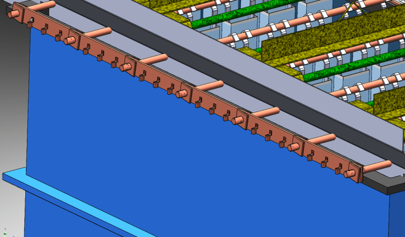

Hello all, I am designing the copper bussing (see attached concept image) for a new zinc plating tank to be built by an outside supplier who specializes in tank building. We are trying to minimize cost as much as we can so we are building the tank to have more electrical capacity than we should actually need but we don't want to overbuild more than necessary, copper is expensive and we are already over budget. The issue I'm having with the tank company is a disagreement over the size of the bus bar that ties our anodes together.
Our current tank is rated for 1500 amps, and the current bus bar is 1/4 x 2, and using the traditional wisdom of 1000amp/in^2, that would mean that this bar is only good for 500 amps. The reason we can get away with this (in my opinion) is because we have 18 wires spread across this bar, going to 7 different anodes, so the amperage is spread out and no one cross section actually sees that full 1500 amps. We have had no heat issues in the past, I would say the current bar is very close to if not room temp, so there is no build up.
We are building the new tank to be good up to 2000 amps, and what the manufacturer is wanting us to do is use a 1/2x4 bar (2000amp). I have the new bus bar drawn up as 3/8x3 (1,125 amp) which should already be scaled up more than enough for no more than we are increasing the tank rating.
Question is, is there some obscure electrical property that I am unaware of that would cause the bus bar to actually see full load at a given point? I wouldn't think so considering how small our current one is that hasn't caused any issues but with how much push back we are getting I figured I should do some investigating. Our current design is fairly unorthodox compared to the designs that this company usually works with so I am thinking that they may just be stuck in the mindset they usually have where the full load is coming in from one end and not distributed like in our case.

waross, that's exactly what I'm saying, we have 18 separate feed wires all spread across the bus bar like you suggest, and plan to do that again on the new one. That's why I don't understand the concern from the manufacturer.
Are the wires feeding the bus or is the bus feeding the wires?
With one supply connection to the bus, some of the bus will be taking the full current.
Each section of bus between wires must considered as a separate circuit for current.
You can't average, but you may arrange alternate feeds.
But the current that goes to the feed wires has to come from somewhere. Where does the main power source to the tank get connected?
18 wires feed the bus bar, the currents goes a few inches through the bus bar to the nearest anode (the cylindrical shape in the pic), then on down the system. At no point is the current funneled through one point.
Got it.
Incoming current arrives through those 18 little objects that look like coffee cups (six groups of three each).
Outgoing current (to process) through those seven round bars, more or less equally spaced along the bus.
Total process current draw = 1500 A.
Assumption #1: balanced current on load side, 1500/7 = 214 Amp per bar.
Assumption #2: balanced current on incoming conductors, 1500/18 = 83.3 amp per conductor.
This means that the bus bar will see a current of 214 A between rightmost bar and first "conductor" connection - even though the conductor is only providing 83.3.
Between second conductor and end bar, bus will see (214 - 83) = 131 A.
Between third conductor and end bar, bus will see (131 - 83) = 48 A.
Between third conductor and SECOND bar in from right, the remainder of conductor 3 current flows (83 - 48) = 35 A.
And so on. Max current density through bus at any point (assuming no failure of incoming or outgoing conductors) is 214 / (0.25 * 2) = 428 A/in2.

I will defer to your greater insite, Gr8blu.
I missed those connectors.
If you are going to use longer anodes, you should upsize your bus.
If you are simply going to add more anodes, the original bus is fine, but add more supply wires.
