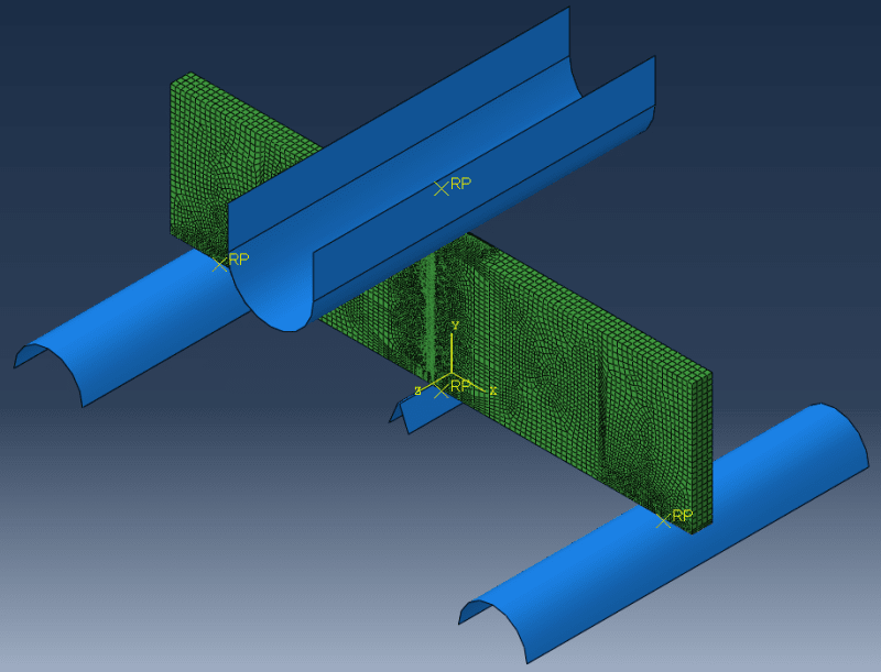

Hi, I would like to create a V-notch on my DWTT specimen (Step-1) and break it using rollers and an impactor (Step-2). Everything works well for Step-1. However, at beginning of Step-2, I have a displacement jumps warning and I get an unresolved initial node-analytical rigid surface overclosure(s) error. I use Abaqus Explicit and work with VUMAT.
Could you please help me with this?

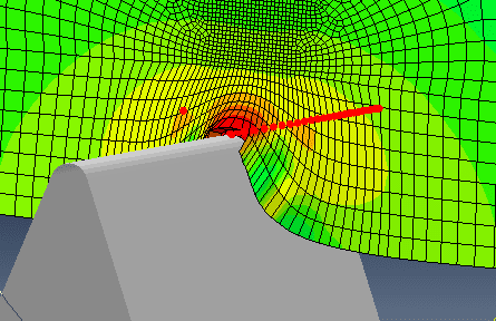

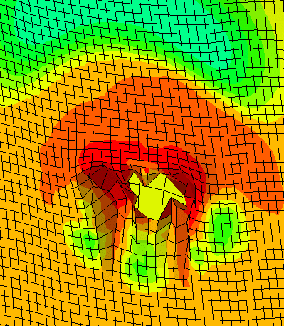

I was able to fix my displacement jump issue. I realized that amplitudes were not continuous when Abaqus goes to the next step. However, I am still getting errors due to overclosure in my last step. This is because I am not having an acceptable element condition on V-Notch impacted surfaces. Elements were excessively distorted and overlap each other at the tip. I tried to use ALE meshing but it is crashing when I apply my desired V notch punch depth. I am not sure how to do this. Is there any other suggestions ?

It seems that you still should significantly refine the mesh around that wedge support. Deformations there are large and the mesh is not ready for that so some elements distort too much.

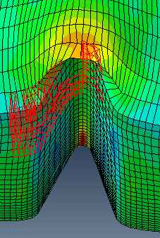

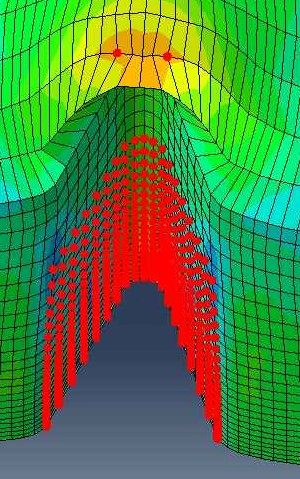

I think my problem is overclosured nodes that I have. In the first picture here end of my first step, I have some over closured nodes.
These overclosured nodes start moving freely when hit my hammer in my last step.
After that, one of the nodes hits these elements and my simulation crashes.
How do I get rid of these overclosure nodes before my last step ?
