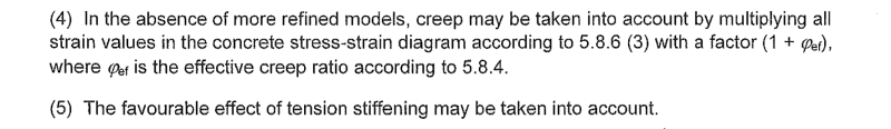

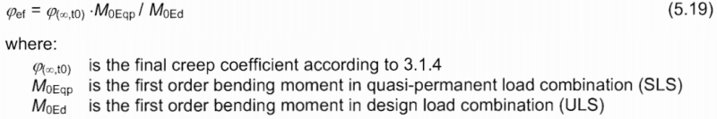

- How about creep? Multiplying all strain values in the concrete stress-strain diagram with a factor (1+φ_ef), where φ_ef is the effective creep ratio. In Eurocode φ_ef is
Again, its value will be varied for different load levels.

- How about creep? Multiplying all strain values in the concrete stress-strain diagram with a factor (1+φ_ef), where φ_ef is the effective creep ratio. In Eurocode φ_ef is What about it?

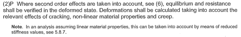

I saw this clause in the code yesterday so I guess it is alright to use linear material properties by properly adjusting the stiffness.
How about creep? Multiplying all strain values in the concrete stress-strain diagram with a factor (1+φ_ef), where φ_ef is the effective creep ratio. In Eurocode, φ_ef is What about it?
How do I take creep into considerations?
Saw this in the code

On the practical side, I wouldn't worry too much about doing a nonlinear analysis if a_cr is too onerous. The nonlinear analysis we are referring to here is geometric only, so forget about plastic hinges etc. It wouldn't harm anyone to consider plastic analysis, but computationally is extremely inefficient. Simple stability analysis would suffice. Try to optimize your building design if it is sway sensitive.

Regarding creep, this goes for slabs/walls and I wouldn't have them in my model therefore I wouldn't expect them to affect the global behavior that much. When you calculate your reinforcement in the slabs simply account for it with the traditional calculation (Eurocode 2 - Annex B).
