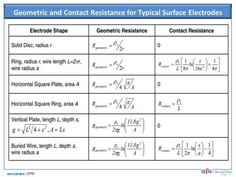

Good afternoon from Spain,
I am interested in knowing the deduction of the earth resistance expression for different earth electrode configurations. For example I've consulted this doc on that shows simple expressions deduced mathematically for a buried rod, a horizontal plate... but I wanted to find a document that studies all the arrangements possible, for example a vertical plate there is missing, and I have found some discrepancies with other resources.
I don't know if you could help me with that, in which case I'd be very grateful.

Below are additional data used in the USA for different earth (grounding) electrode configurations.
Please notice that some of the formulas may be different probably because was developed based on a regression analysis with approximation. It is suggested to plot the formulas for similar cases and check how large is the discrepancy or similarity in a particular variable range.
1) Electrical Power Research Institute (EPRI):
2) Source: IEEE Std.142

Is it possible that you quote the EPRI document you got that table from so I can look for that?

The EPRI's reference requested can be found in Table 4-1; Geometric and Contact Resistance for Typical Surface Electrodes.
Publication:1012313; "Outline of Guide for Application of Transmission Line Surge Arresters—42 to 765 kV"; 2006.
