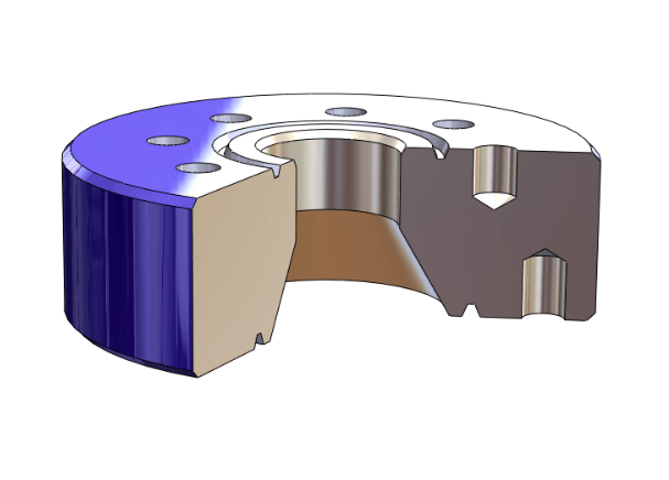

Basically you need to get someone to make up a plate a bit like this
You will need bolts spaced alternatively so the valve will not be centred or the flange will not be centred as normal (bolt holes flat.
You could start with a blind flange and machine the back side, drill and tap holes for the bolts or just start with a circular piece of steel at least as thick as a nut so that you can tap the holes to insert stud bolts and then machine the raised face into both sides.
It will look truly terrible so get another one on order as soon as you can.

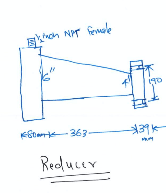

Below is the Existing pipe fitting upstream of the valve which has to be replaced. A strainer ,then this reducer after that 4 inch MOV that has to be replaced. That is the arrangement
Yes, but do you have room in the piping overall to add in another probably 50mm in total.
Plus those connectors need the flanges to be slid onto them. You can't just drop the valve in.

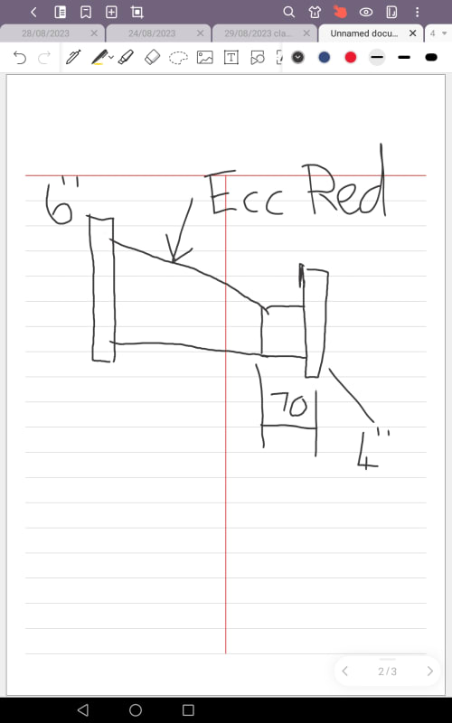

on the spoolpiece that goes from 6" to 4", did they really weld the 4" asme flange directly onto the reducer? often they will put a short piece of pipe on to make it easier to put the bolts in. see below.
if that was the case you can cut that short piece of pipe off and weld a replacement en1092 flange on to replace the 4" asme flange. then do the same on the other side. might be your best best. ive done it plenty. if a valve pcd doesnt match the piping we cut the piping flanges and weld on new ones that match the valve. of course it does depend on the exact configuration...
and of course if they did weld the 4" asme flange directly onto the reducer then that gets interesting...
Dear Joe591
It was directly attached to the Reducer. This is a GRE Piping work.
Yeah, I missed the GRE part. Was reading a bit too fast. Yeah, you got yourself an interesting situation...If there is no give in the pipe then you might have to send the valve back or get a new spoolpiece made on either side of the EN1092 flanged valve...
