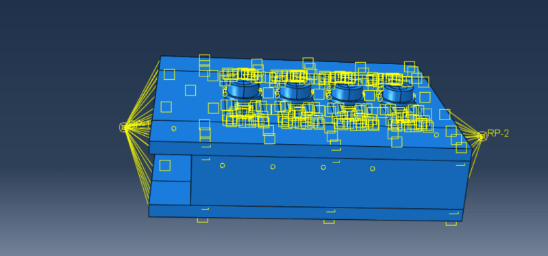

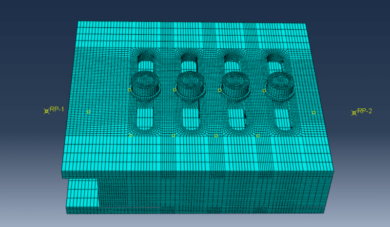

What are the boundary conditions ? Can you attach some pictures showing this model with visible mesh ? Which material model do you use ?
I fixed my upper and lower place on the left using a reference point and applied displacement load on the right of central plate using another reference point. I am using A325 bolt and A572-50 plates.

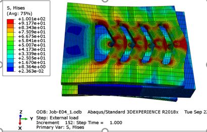

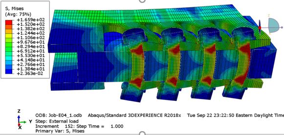

Also, what are the contact settings in this case ? And can you attach a pocture showing stress plot on the deformed model ?

I apply the load to a reference point and couple the point to the end cross-sectional surface. Then request the force displacement in output history. Does it capture the behavior well? Is there any better way to get the Force VS displacement plot?

I used find contact pair option to get the pairs and make sure the master and slave fulfil its requirements. Contact property is same for all surface with coefficient of friction 0.3.
