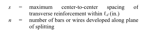

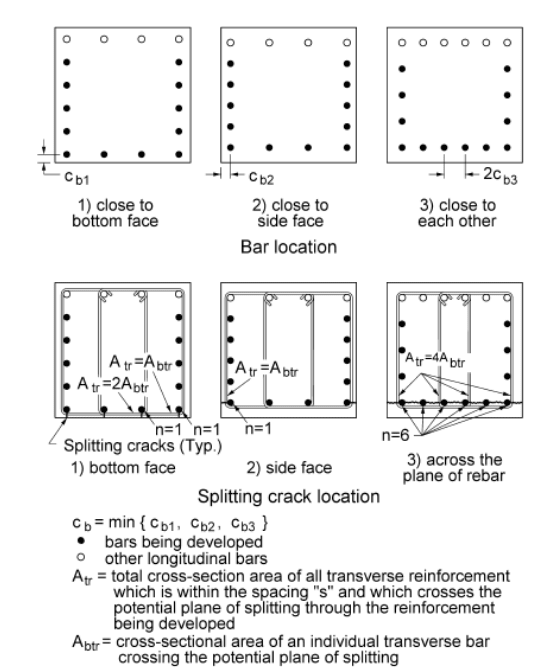

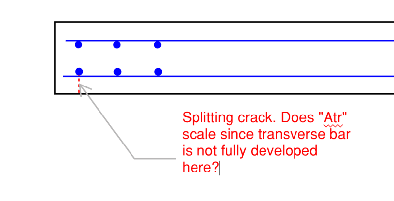

Hi Everyone,
When calculating the development length of a straight bar you are allowed to take into account the transverse reinforcement index which gives a benefit when transverse reinforcement crosses the splitting crack location. However, AASHTO or ACI does not clarify if the area of transverse reinforcement crossing the crack location should be scaled downwards if it is not fully developed at this location. Take for instance, a slab as shown below, where I am determining the development length of the bar at the edge, and the crack crosses a transverse bar that is not fully developed. When calculating Atr, can I use the full area of the transverse bar, or does it have to scale? Since the transverse reinforcement index calculation doesn't take into account yield strength I would assume you can use the full area, as the calculation would provide the same results for 60ksi or 100ksi yield strength.
