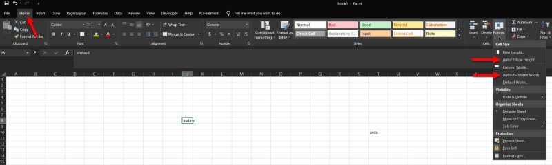

I Google searched it:
How do you autofill the width of a column?
Below are the steps to do this:
1) Select the column you need to autofit.
2) Click the Home tab.
3) In the Cells group, click on the 'Format' option. This will show additional options in the drop-down.
4) Click on the 'Autofit Column Width' option.
