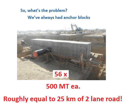

Well yes you can build large anchor blocks. REDICULOUSLY LARGE ANCHOR BLOCKS! The petroleum facilities of the mideast are full of them. Big ones. Pyramid size ones! Thank SaudiAramco for that. I think I understand why the Egyptians built them and my take away was their prime objective was not to anchor pipe. My theory is that pipe stress engineers, note as opposed to pipe flexibility engineers, today use them because the computer model slides off the paper if they don't have one. Caesar blows up. If Caesar didn't require at least one anchor to make the math work, most all anchors would magically disappear. Why do you need an anchor at 150? The best way to design pipes for lowest stress is to iterate anchor locations. Start with some relatively benign anchor configuration, anchors far away from equipment in the middle of a long pipe segment, maybe in the middle of a loop, maybe not. Find points along the pipe where movement is as near to zero as possible, then move the anchors to those locations and see if stress went up or down. If it went up, do the opposite while removing as many anchors as you can. Repeat until stresses drop to acceptable levels. Get a piece of 12 ga copper wire and make a physical analog model to help you to visualize the cause-effect relationships.
Picture from a presentation I did at the 2012 Abu Dhabi Pipeline Summit about how NOT to design pipe anchors.
This is what a 500 Metric Ton Anchor Block looks like. Now picture 56 of these things!
I just happen to think that this is the ultimate antithesis of good pipe design.
P.S. I hate looking at pipe stress tables, especially in Kilonewtons per mm2 or something. The occasional isometric view is better. I can visualize the deflections in my sleep.
“What I told you was true ... from a certain point of view.” - Obi-Wan Kenobi, "Return of the Jedi"
