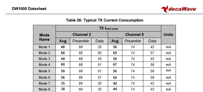

Their datasheet implies otherwise:

A common application for "Indoor GPS" seems to be flying drones; hopefully making the hype word 'autonomous' into something less of a BS lie. (This refers to the many university labs that hyped their work in "autonomous drones", but the environment was lined with curtains and IR Tracking Cameras, and the so-called 'autonomous' drones were all controlled by a PC hidden backstage.)
Given the power consumption of a drone's motors, an extra few mA wouldn't be a major issue for that sort of application. Other applications may have to await the Mk II version.
