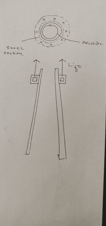

Design a circular steel section to lift a structure 3
One time use, or repeat use? What is the geometry and weight of the structure to be lifted?
I think the question goes a little beyond homework...
robyengIT said:
It is a stack liner with weight of 100T. So, need eight points to support it to prevent stress concerntration.
goutam_freelance said:
It is a stack liner with weight of 100T. i need to uplift this structure and design a section for it
Are you using metric or US units? What is the size of the liner (D x H), and what is the purpose of lifting - for installation or transportation?
r13 said:
Yes, metric unit. The liner is 120m high with diameter of 3.844m at top. The purpose of lifting is for installation

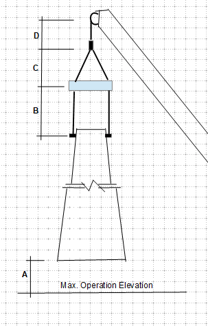

Are you sure that you have the equipment/crane that can lift the liner by one piece? It is very tall and heavy.
R13,
yes the crane can lift the liner by one piece
I think the next step is investigate the crane operation range and permissible/available space to set up the lifting assembly, and operates safely, similar to the sketch below. Note that the optimal situation is having matching number of lifting points on both top and bottom of the lifting beam/ring. Then, what is the size of lifting cable required, and how many cables the crane hook can accommodate? All need to be looked into before you can think about the design of lifting beam/ring. I hope you can get help from someone experienced on this type of operation, so you won't waste time chasing the unrealistic solution.
At the meantime, you shall familiarize yourself with the standard for the design of lifting devices below hook, ASME BTH-1.
Thank you very much for the reply. I am actually interested to calculate the tubular steel section which need to be assembled in the liner top such that it can sustain 100T load while lifting. I am confused of how to model it.

As for the lug, why not weld on vertically oriented ribs so as to put the welds primarily in shear, as opposed to some ring as you show?
