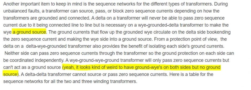

I just came across an interesting article here :
The article mentions the wye-ground-wye-ground as not representing a ground source, as I understand that the fault current returning to the transformer secondary, with the source at the primary, will be opposed by and equal amount divided by the turns ratio going out of the primary neutral back to source. This is confusing enough for grounding design with respect to the actual fault current going to the grounding grid since most of the wye-ground-wye-ground transformers have only one neutral point.

Yg Yg transformer could be a ground source if the transformer is a 3 legged core type construction.
This effect is called phantom tertiary winding with zero sequence circuit looking like this:
This is not an issue for 5 legged core or shell type transformers.
Like folks here said, transformer passing through zero sequence current is not the same thing as transformer being a ground source. The former means if there is ground fault on secondary side, the primary side will also see the fault as ground fault. The latter means if there is a ground fault on the primary side, having this ground source tx will contribute to the ground fault.
