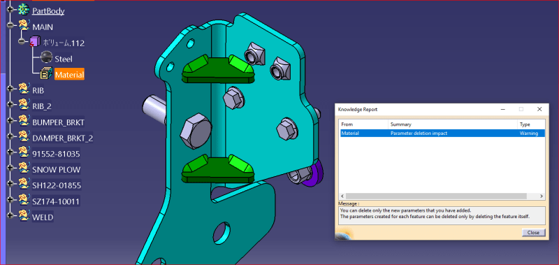

Nov 4, 2019 #1 CAD2015 Automotive Joined Jan 21, 2006 Messages 2,079 Location US Hi, I have run Apply Material to the current file. Now, I want to remove the "Material" and the "Steel" in the tree, but it won't delete. Does anybodyy know how could I still delete this item from the tree? Thanks, CAD 2015
Nov 5, 2019 1 #2 LWolf Automotive Joined Mar 20, 2007 Messages 530 Location SE you need to make a copy of your object... or export/import via step... regards, LWolf Upvote 0 Downvote
Nov 5, 2019 Thread starter #3 CAD2015 Automotive Joined Jan 21, 2006 Messages 2,079 Location US Thanks LWolf, CAD 2015 Upvote 0 Downvote
Nov 7, 2019 1 #4 ferdo Mechanical Joined Jul 4, 2002 Messages 2,859 Location RO Can you give a sample part? I want to see if my macro is working on that sample Regards Fernando https://www.youtube.com/playlist?list=PL9mSHa4SOedV3dr0D3kfIWFUg7mIYm94k Upvote 0 Downvote
