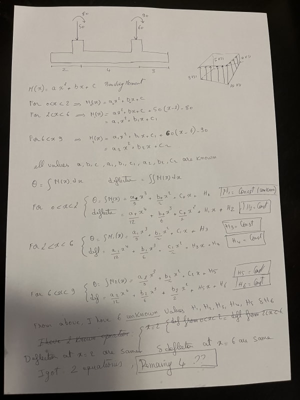

I am trying to get the deflection D(x) under a combined foundation.
I manage to get the function bending moment M(x) by dividing the area in 3 places.
- Equation 1: from Edge of foundation to First Column C1
- Equation 2: From Column C1 to Column C2
- Equation 3: From Column C2 to the edge of foundation
by integrating the differential equation of the deflection Curve, I got the function deflection(x) but with 6 unknowns parameters (Const1, Const2, Const3, Const4, Const4, Const6)
in order to solve these unknown const, I should have 6 equations.
But what I have is just 2 equations.
the First one: Deflection from Equation 1 at C1 = Deflection from Equation 2 at C1
Second one: Deflection from equation 2 at column C2 = Deflection from equation 3 at column C2.
how to get the remaining 4 equations.
I cannot consider the deflection at column 1 and column 2 = 0 cause underneath is soil.
any advise or help so I can proceed cause I already stuck for almost 1 week.
Seems to me, if you want the deflection of the foundation, you need to know (or assume) the elastic properties of the soil as well as the properties of the concrete. Maybe you have this covered?
You are using the same symbol for constants of integration and column numbering...very confusing.
I don't know if this is even appropriate, but have you tried using the Macauley system to eliminate four integration constants?
I don't understand your comment about p1 to p4 (swipe back to Distribution of Pressures...etc.). Can you indicate how these four pressures are calculated using your method? If you are neglecting the soil stiffness, deflections should be easy to calculate using normal methods, but they neglect a significant variable.

Thanks gentlemen for your reply,
I changed the constants as you were right, it was confusing using the same numbers.
I got the pressure by using P / A + P * Ye / Ix * y + P * Xe / Iy * x and then using the Chart Ten to calculate K in case there is tension beneath the foundation.
The way I did is not correct?
I did not understand quite well from the comments above, however I am going to go through it in more detail but doing some search.
but is there a know method I can use? cause I don't know what is the old school method.

If flexibility of the foundation is not a concern then once you have the bearing pressure then you have all the information you need to form shear and moment diagrams for the foundation system from your sketch. Consider rotating your image 180 degrees and thinking of the bearing pressure as an applied distributed load, the columns as pin supports, and any column moments as concentrated moments. This reduces the model to a statically determinate beam with a cantilever on either end and the internal forces can be solved through section cuts and statics alone.
To address your biaxial bending condition each section through the rigid foundation will produce a shear, moment and torsion resultant at the cross section centroid. Again though your system is statically determinate so all the information to form the internal resultant is available without any compatibility equations.

That method is not appropriate for a foundation.
If you had uniaxial bending you could do beam on elastic foundation:
EI dy4/dx4 + ky = q
For the biaxial bending case it is a two-dimensional problem and generally best solved with the finite element method.
Thanks a lot Celt83 for all your replies, lets consider it first as one uni-axial moment.
by using EI dy4/dx4 + ky = q, I will get 6 unknown values to be identified.
to solve them, I need to have 6 equations. is that correct?

No, it is not correct! Look up Macaulay's Method. You need only two equations; and there will be only two constants of integration.

@BAretired thanks a lot, yes with Macaulay's method I can solve the 2 unknown constants, but I need to consider that the displacement below the 2 columns are zeros.
Is it correct to consider the deflection underneath the two columns are zero?

@Once20036 Appreciate if you can look on the paper where I wrote all details which I did.
you can't compute deflection that way for a beam on soil, the soil reaction is coupled to the deformation.
why are you trying to compute deflections anyway?
If you absolutely must know the deformation then you need to get the settlement information associated with your bearing pressure from the geotechnical engineer.
If you are determining bearing pressures from the rigid base assumption and using P/A +/- M/S then the settlement follows rigid body motion and the only consistent means of determining settlement would be to ratio your corner settlements based on their respective bearing pressures and then the settlement at any interior point would found via bi-linear interpolation from the corner values. Any other means of determining settlement would be inconsistent with the rigid foundation assumption used to determine the bearing pressure.
If you want to consider the foundation flexibility and only have uniaxial bending then you can do a beam on elastic foundation analysis.
If you want to consider the foundation flexibility and you have biaxial bending then you must do a finite element analysis.

If this is the way pressure is being calculated, the foundation is not being designed as a beam on an elastic support. It assumes that the foundation is rigid relative to the soil supporting it. I'm pretty sure that is the way most engineers would approach the problem. I know I would.
It is not necessary to create a single expression for the entire length of beam which entails two cantilevers and a span. Simply design each cantilever for the calculated soil pressure and resulting moment. The span is just a simple beam with a moment applied at each end. That is the "old school method" and perfectly adequate for the current application.
