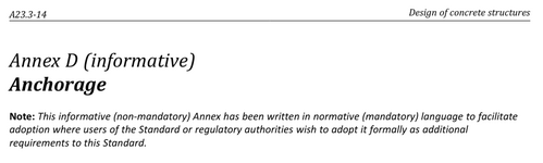

Anyone familiar what the CSA A23.3 equivalent to this requirement past 20db is for epoxy?
The requirement lives in ACI 355.2, which A23.3-14 refers to on page 21. If there's wording in A23.3 equivalent to ACI 318-19(22) 17.1.2(e), then I imagine that the requirements are the same. Note that I am wholly unfamiliar with Canadian codes.
I'll lay out the code path here, once more, since it's not abundantly clear at first blush:
1. ACI 318 states clearly that the provisions of Chapter 17 only apply when an anchor has met the assessment criteria of one of two other documents. For adhesive anchors, it's 355.4. For mechanical anchors, it's 355.2. Simply, if you think something is an "anchor," but it's not qualified by ACI 355.2/4, then it's not actually an anchor in the eyes of ACI 318. A simple example of this is mechanical anchors smaller than 1/4-inch in diameter. Tiny "anchors" like that are not subject to the provisions of Chapter 17.
2. Looking to ACI 355.4-19 reveals early on in the scoping section that it does not apply to embedments greater than 20*db. See 1.2 and 1.2.1. Thus, post-installed reinforcing bar embedded more than 20*db cannot be qualified for design in accordance with ACI 318 Chapter 17.
@EngDM look at D.1.3(d)...looks like this is in part of the code that I would call non-statutory were it an American code. Reading the note makes me think that it can indeed be adopted as statutory on a jurisdiction-by-jurisdiction basis.
