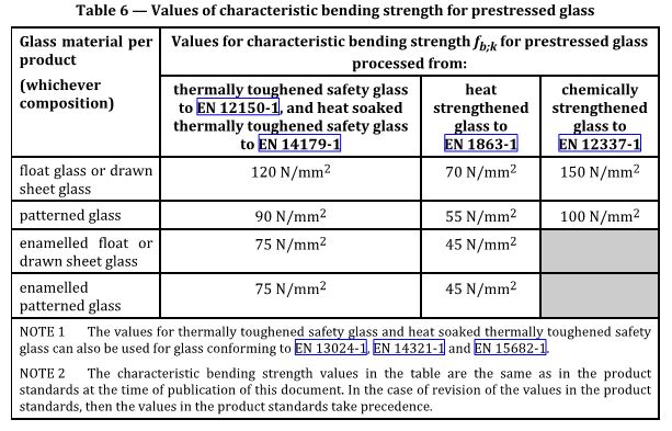

If you're getting 35mm of overlap, that's probably enough to keep your glass from disengaging due to deflection. I disagree with the contractor that designing the perimeter frame isnt important, because the wind loads/barrier loads will be transferred to the frame. The construction is only as strong as its weakest link.
I also want to second what jjl317 said about using a safety glass and considerring the negative effects of decorative glass finishes. Here in the UK, we use BS EN 16612 for this. I've attached the relavent table below:
