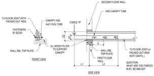

Hello everyone,
Every once in a while I need to design a deck with joists fastened to the side of floor framing. See attached. I am wondering what your approach would be to come up with shear forces in bolts B1, B2, and B3.
See attached and thank you for your input.

I would assume all the uplift is being resisted by bolt B3. I would design B3 to resist the force: P x L1 / L2. The other bolts, B1 and B2, would just be there to provide lateral stability for the deck joist. This approach should be conservative.
In reality, I'm not sure how the loads would be distributed to the bolts. I can speculate that perhaps most of the load would want to go to bolt B1 initially since it would technically be the stiffest load path. Since the lever load to B1 would be very high, I imagine the wood grains would crush at the bolt and the resulting deformation would allow most of the load to be redistributed to bolt B2. Then the same would occur at B2 and most of the load would end up at B3. The end result is maybe a linear distribution with B3 taking 2/3 of the uplift, B2 taking 1/3, and B1 taking close to zero. Again, just speculation.
Isn’t this just a continuous beam? Any number of indeterminate analysis methods will solve for the reactions. Model it once as if the bolts provide rigid support and then again idealizing the bolts as spring supports, to account for wood crushing and/or bolt plasticity. The reality is somewhere between the two, depending on how stiff you model the springs.
You can manually check for which of the dowel limit states from the NDS controls (ZI, ZII, etc.). Select a spring stiffness based on which failure mode happens first (i.e., wood crushing, etc.).
This.

Also, don't use bolts if you can avoid it. Use a cluster of smaller diameter screws at the back end (where Bolt 3 is), and then a staggered pattern down the length. Wood responds better to lots of small fasteners than to a few big ones, where crushing comes into play a lot faster. There are limits, of course, and too many will just tear the wood to pieces, but putting 6 or so 1/4" self drilling structural screws in lieu of a single 3/4" bolt will have much better performance.

Why not just put a couple fasteners right over the double top plate and then fasteners at the end (B3) ?

I would do that and have fasteners between. I'd be a little concerned with buckling if there was nothing from B1 to B3.

Attached is the actual situation. The HSS canopy tube is attached to the TJI floor joist.
1. I agree with small-diameter screws, but due to the steel tube, I think I need to go with bolts.
2. When I model B1 B2 B3 as supports, B1 receives crazy (and unrealistic) uplift, B2 and B3 receives a very minimal forces.
3. I would consider spring supports, but could someone elaborate on what k/ft value each support would have?
4. If someone has any thoughts on how to reinforce the floor framing (tubes at +- 32" on center, joists at 16" o.c.) other than blocking, please be my guest.
Thanks,

I'm lost. The Front View does not show tube steel or an I-joist.

I don't have all the information that you do, but I would generally prefer an alternative solution to this. See points below:
  1. Is there a reason why you have to use an HSS section? I would prefer a channel instead, which reduces the eccentricity at the connection to the floor joist. There's also less risk of water/moisture damage versus the closed HSS shape which has more potential to trap moisture.
  2. I probably wouldn't use an I-joist to connect this to, even with the webs packed out. I would prefer to use LVL joists in this location instead. The LVLs should have minimal shrinkage similar to I-joists.
  3. In terms of modeling this in software, I'm not surprised by your results. I would probably model it with only two supports, one at the wall and the other at B3. I think the results you're getting are somewhat in line with what I was thinking in my post at the top.
  4. As far as using bolts go, that's usually how I connect wood to steel. In suggesting multiple smaller fasteners above, I was assuming this to be a wood to wood connection.

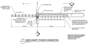

This is what I came up with. The 4" channels don't work for deflection. I modeled the bolts as spring supports (100 lbs capacity / (1/16" deflection) = 19.2 k/ft). See below, any input will be greatly appreciated. I pasted images instead of attachment, as requested.
So your original drawing was not even close to being to scale? That would be helpful in the future.
I take back what I said about this being OK with I-joists.
Not sure why you are using so many bolts and modeling that bolted connection ain't gonna reflect reality.
How about double channels? Using two channels with the joist sandwiched between is a much better connection IMO. The HSS along one side creates an eccentric connection which will be trying to twist the joists.
The load is +- 250 - 300 lbs at the tip of the cantilever.
You're looking for feedback on this, so can you explain how you arrived at this load? And why is the load applied at the end of the cantilever and not distributed evenly over its length?
