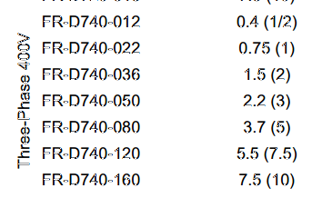

I guessed that a 10 second decel would fly for a test on the heavy spinning blade carrier and it did. But, that was too long for a rundown so we went to 5sec. DC link over-voltage fault.. So we stepped up a second - 5 times until we were back at 10sec and the fault quit happening. Now I need to find a brake resistor for a Mitsubishi FR-D740-160 and their manual refuses to give it up. Even their braking resistor manual refuses to state which resistor for this 7.5HP/5.5kW drive. Sigh.

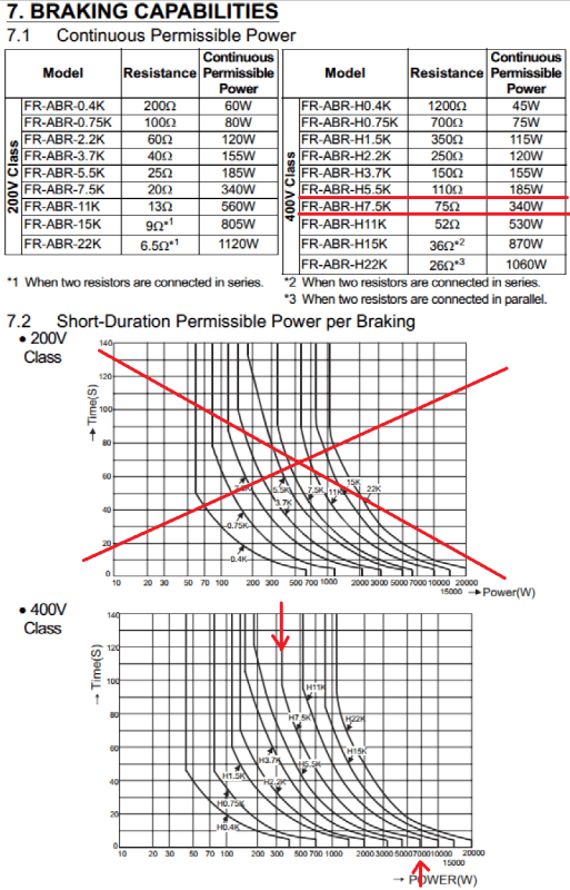

Could it be that the drive doesn't support Dynamic Braking? Not all do, the drive must have a 7th transistor for the DC Chopper, and not all VFD mfrs build that into their units unless you ask for it. This is especially true of VFDs that were tailored to be inexpensive for the HVAC market. If that's the case you can still do it with an EXTERNAL chopper, but it needs access to the DC bus. Some of the Mitsi drives I have used needed an external "Braking Unit" that connected to the DC bus terminals of the drive, which was that chopper and the sensing / logic board for it, then you connected the resistors to THAT unit, not directly to the DC bus. So the information on the correct resistor only came in the manual for that Braking Unit. Which Mitsi series do you have?
That's really neat Comp! I love the visual feedback that provided too.
Jeff: That does concern me a bit because there are a bunch of options including 1) add a resistor 2) add an external braking unit 3) add an external regenerative unit.
But what I see is:
"OR MORE" This is a FR-D740-160 of a series called:
Wiring shows:
But nowhere does it state which FR-ABR is correct in the manual.
Tick Tock..
Just got off the phone with a Mitsubishi Rep. Mitsubishi states the FR-ABR-H7.5K is the correct resistor even though the ABR manual excludes the D740 in its list of drives.
$260. And 400mm long!!! Gack.
At least I have the answer. Thanks all.
