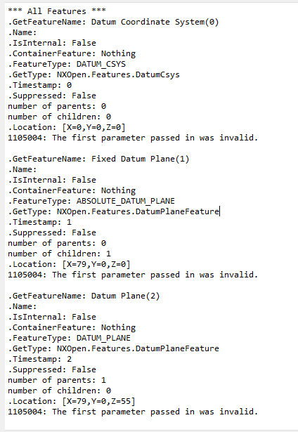

What I figured out is when plane is fixed, the type is DatumPlaneFeature, but when I create associative plane, i.e. offset plane the type is DatumFeature. That's why I added exception for DatumFeature. For the DatumCsys feature, Yes I know, some time ago I asked about moving some object for specifics layers. Right now I encountered problem with planes, that not each of them moved to desired layer.
With best regards
Michael
Hmmm, that isn't how it works for me. I started a new file in NX 12, created a fixed datum plane, then created an offset plane from the fixed plane. Code that loops through the features reported both as .DatumPlaneFeatures.
What version of NX are you using? Can you post an example file?
www.nxjournaling.com
The old style dialogs appear if you double click datum plane 6, 7, or 8. I suspect these older features are handled differently. If you need to work directly with the features, you might want to contact GTAC to see if they have a work-around.
If you don't need to work with the feature, you can iterate through the part's .Datums collection and work with the planes and axes directly.
