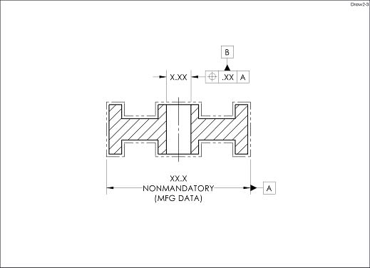

ASME allows you to identify manufacturing data as "nonmandatory":
Also:
Since I have no idea how your "wheel" design actually looks like, I leave it to yourself to assign datum targets; I will just illustrate possible relation between temporary and permanent datum features:

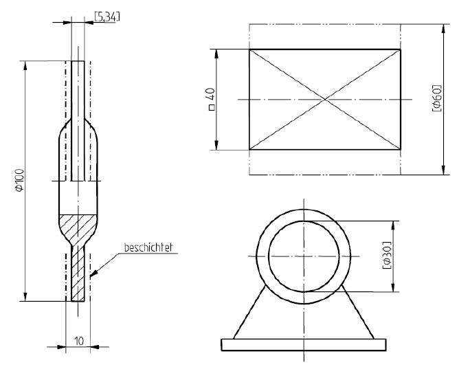

Per DIN 406-10 dimensions of a part prior to a machining or coating process are indicated by square brackets.
This is often used on cast parts that require machining, so would definitely fit here.
You could use that and add a note the square brackets indicate raw/as cast dimensions.

OK I see what your saying. On your example does that mean that don't have to use Datum A, but they could if they wanted? The word non-mandatory suggests a choice? Also, how would an inspector verify that positional tolerance on the final part?
Any reason why I would choose this method over assigning datum targets?
By all means, no. On your drawing you show datum targets the way that implies 3-jaw chuck, or whatever fixturing you chose.
To some extent. The producer of the forged blank may chose larger or smaller allowance for future machining, so you are giving him that kind of freedom.
He wouldn't. The idea of temporary datum features is that they may be destroyed in process. The tolerance may be checked "in process", but not necessarily on final part.

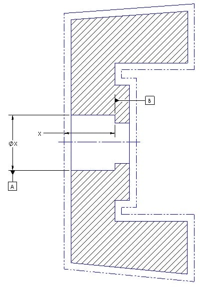

Thanks CheckerHater,
Its starting to make a bit more sense.
So far my part looks a little like the below:
I'm still struggling to decide if i really need to define and relationship between my forged and my final machined part. As long as I get complete clean up and a finished part I'm happy. In my instance the wheel has a deep dish so there is only really one orientation of the forging that will fully enclose the machined part.

You could still use it if you define it in the notes: "SQUARE BRACKETS [X.XXX] INDICATE PART DIMENSIONS AS CAST."
Inspection dimensions using the DIN 406-10 inspection symbol are quite common on US drawings:
Sometimes, but not always, accompanied by an explanatory note like this:
