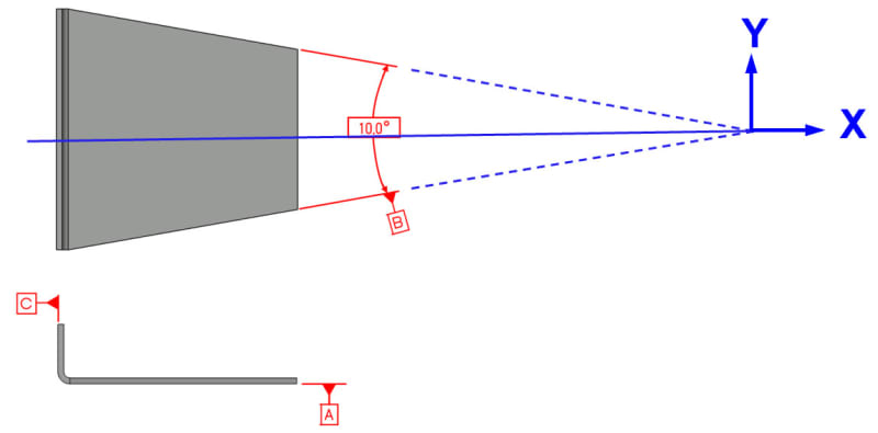

Datum on angular slab centerline 2

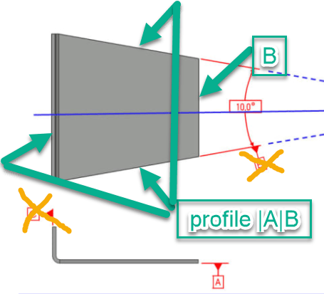

I think in theory it is. In this case you don't need C (tertiary) because B is able to arrest all remaining degrees of freedom.
You put a profile feature control frame wrt A, with two leader lines pointed to both surfaces, and attache datum feature symbol B to the profile FCF.

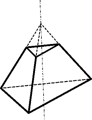

From what I understood, the apex(as shown on the fig below) will be the datum point of this part, this is almost same as the conical case (e) on Figure 7-3 2018 version. Am I right here?

Standard allows us to use any geometry as a datum.
Question is, how to identify that geometry correctly.
With all necessary precautions the final DRF may look like this:
The general idea is similar to, for example, Y14.5-2009 Fig. 4-44, but since datum is formed by 2 separate non-coplanar surfaces, each surface is identified individually.
Little edit: 30 deg angle better be basic.

Thanks for your input and figure, may I understand this way: the datum point will be different(as shown below) if no profile FCF callout as you recommended.
Season
@ SeasonLee:
You can have datum point anywhere you want.
My example was just in agreement with greenimi note that tertiary datum may not be necessary.
You can force your datum where it works for you. I referenced Y14.5-2009 Fig. 4-44; the very next Fig. 4-45 shows how to use customized datum frame to place your datums the way you need.
CH

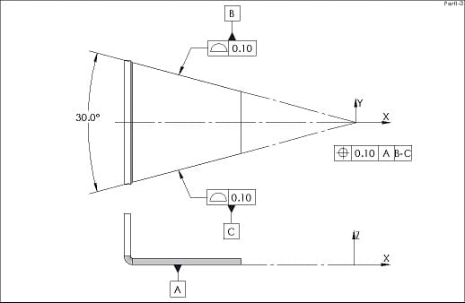

A simple question: Is your secondary datum feature B-C a center plane callout on the new DRF?
Season
Yes, that's the way I see it:
2 flat surfaces on the angle to each other give you center plane:
And, like I mentioned, you can also add your own datum plane and create your own DRF
Thanks, CH.
I think the OP's secondary datum feature B is also a center plane callout, I am anxious to know what is the differences between them.

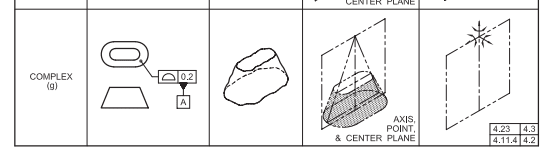

It's curious that the tapered example "complex" feature only produces one center plane; the planes tangent to the curved faces should also create a center plane, otherwise that axis could not be determined. It's at the intersection of two center planes. It raises the question of what it means on a manufactured part that those planes don't necessarily intersect at a single point.
Here's a variation that locks 6 degrees of freedom - the top and bottom surfaces aren't necessarily parallel to each other or normal to the axis. The axis is arbitrarily oriented relative to the 3 main faces. It does not appear to fit within the suggested possible feature types in ASME Y14.5-2009, figure 4-3.
