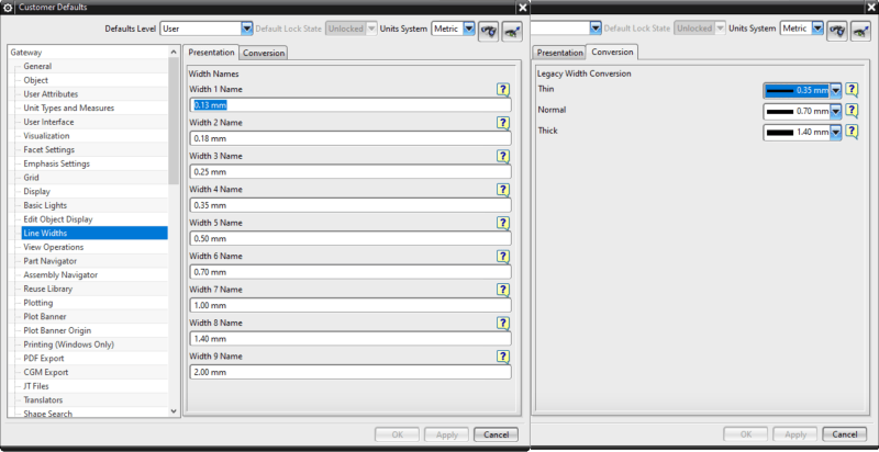

On customer defaults I found this:
But lines created on file has values from 5 to 13. I'm not sure if I open file from created on different computer I will get the same values.
With best regards
Michael

Hello everybody,
@cowski thank for Your code, it help me alot.
Finally I found some time to finish it. I figure it out:
Code:
.linewidth
show values from 5-13, but
Code:
NXOpen.DisplayableObject.ObjectWidth
needs values from 1-9 or thick, thin and normal.
Below is my code. Maybe it will be usefull to someone.
