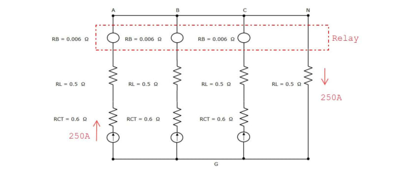

Is there a specific reason for not forming the CT star point in the yard especially when dealing with UHV substations?
CT star point is formed in the yard for EHV and UHV substaion.
As use 6 wires for 3 CTs? We typically connect the CT star point in the circuit breaker cabinet and then use a 4 wire cable to run to the control house.
Assuming this is not a question of best location to implement single-point-grounding for CT circuits.
For anything other than a SLG fault there will be less secondary voltage with a four wire circuit than with a six wire circuit. That’s a good thing.
Hi Davidbeach- Why is that? I mean why the burden should be lower in case of 4 wire ?
They like using extra wires? There is nothing wrong with running 6 CT wires the whole distance if you wanted to.
With 6 wires, balanced phase current has to flow back to the star point before it adds to zero. If the star point is at the CT, the distance is short and there is little resistance (burden).

Thank you all for great suggestion and comment. In the mean time i have come across a case wherein very high fault on A phase( 250A secondary current on 5 A relay) caused sufficient voltage across healthy CT secondary of remaining two health phase to drive them into saturation and caused maloperation. needless to say it relatively rare occurrence
please see attached sketch
One of the possible solution was not to run common neutral wire
dfdt,
The voltage developed across the CT secondary in faulty phase comes to ~400V. But, the voltage across the healthy phase CT / relay circuits is 125V only.
If CT rated knee point is >125V, the CTs in healthy phases will be offering very high impedance and there will not be current in those circuits (except the magnetising currents corresponding to 125V).
This is true with 6-wire scheme as well (with minor changes due to change in lead burden).
This is my view.

I agree with you view point. In this case other two healthy phase CTs had remanent flux from previous high DC offset fault and hence were quickly driven into deep saturation without corresponding high primary current. The relay in question is low impedance bus protection scheme which was meant to restrain for this through fault but did not.
remnant flux from previous fault - can be relevant only if the faults are successive without much gap between them (that allows remnant flux to die down).
