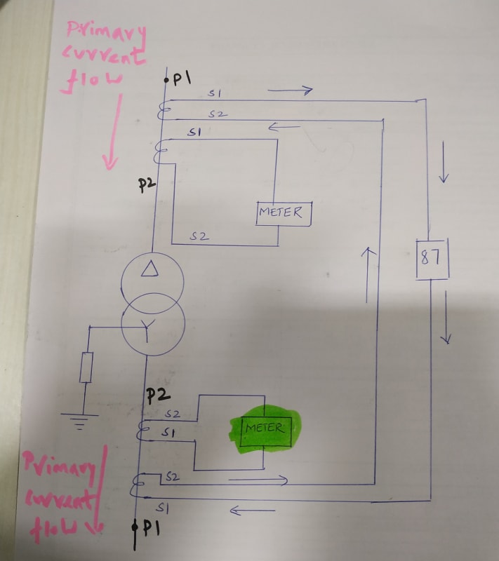

Is the attached arrangement of CTs correct for differential protection of transformer? The "P2" of CTs on both the primary & secondary of transformer are towards the transformer.
