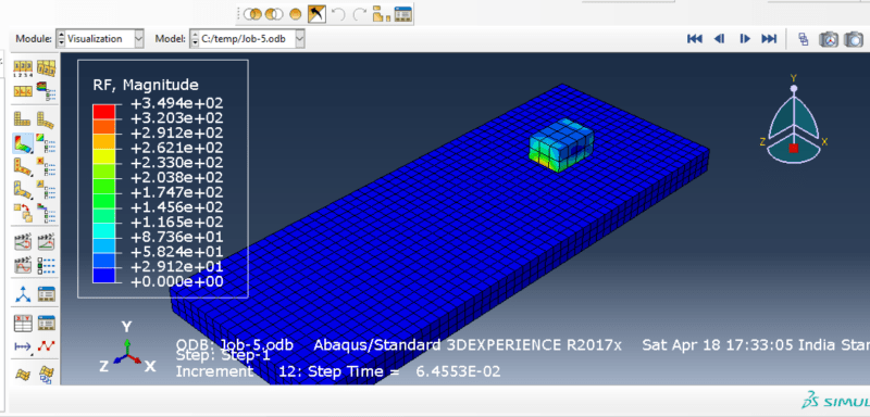

As seen in the picture, there is no reaction force in the lower body. the contact pressure distribution is also shown in figure.

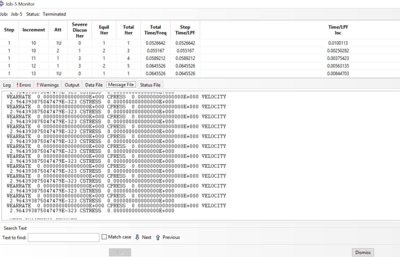

when the subroutine is called, the value of velocity shown is very low and Cstress and Cpress is shown zero.
What may be the reason for it. please help me to solve this issue
Reaction forces can be read only for nodes that are constrained in a given direction.
In previous thread we were discussing the boundary conditions. How are they applied now ?
Boundary conditions are applied only at the surfaces. The body is constrained at top surface in the upper body and bottom surface in the lower body.
The lower body is completely fixed (all dof's) at the bottom face. For the upper body, all rotational degrees of freedom and movement in x direction is fixed on its top face. pressure is applied on the same face only. i tried giving motion in z direction to upper body by giving periodic motion to top face also tried it by giving motion to entire top block.
Even though CPRESS is shown in figure, umesh motion subroutine displays it as zero.
