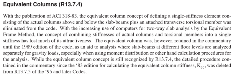

While digging a bit more into the theory behind these provisions, I also found this particular part of the PCA notes to ACI 318-11 interesting:
Reading that paragraph, it implies that the calculation of the equivalent column stiffness is only required for hand calculation methods like the moment distribution method. Does that mean that if you're using a frame analysis program, then it is not necessary to calculate the equivalent column stiffness and simply using the cross-sectional properties of the columns is sufficient?
With general frame programs like RISA-3D, RAM Elements, etc. it is not possible or incredibly difficult to reduce the column stiffness for the effect of the torsional members.
In theory the torsional members still need to be modeled, and you'd need to distribute the moment from those elements into the slabs for design purposes. In practice I believe the most folks are doing is the rigid end offsets for the columns and maybe the slab/beams in these general frame programs.
Programs like SpSlab and Adapt I believe have a method programmed in to include the torsional member stiffness reduction on the columns.
That makes sense, and I would be curious to know how common/prevalent it is to follow the procedure outlined to the letter, or whether the rigid offset simplification is considered good enough.
