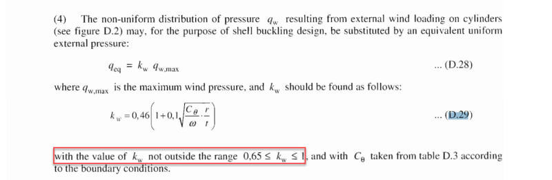

I get kw to be less than 0.65, does anyone know what this means? I double checked with a coworker but they did not know and my calculation seemed to be right.
