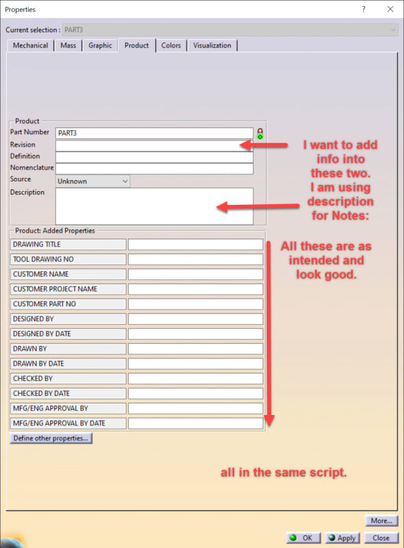

Hello all,
I need help and would like to Create and import into a CatPart and CatProduct the Properties with a catscript.
I believe I have the Creating part down and it works.
I just need to import into existing part properties like "Description" "Revision" some info
In that field will be my Notes for the drawing and so on.
I have been able to get this far with examples found on internet of others helping.
Yes, this is for being able to import into my drawings so the info is always taken the catpart.
My Catscript for the drawings works great.
Below is what I have so far and works.

Thanks for the reply,
Yes I did. Many times. But the search responds to what is entered.
I may not be using the correct terms to give me what I need.
I will try again. Did you find something?
Thank you again for those examples.
I copied them and tried them and they are not producing what I need at the moment.
I am just lacking and need to add info into the description field and revision.
Thank you for your help....
