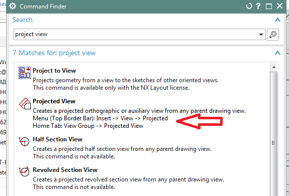

I will do the best that I can since I do not know what version of NX you are on.
go to you command finder (Help (pull-down) -> Command Finder) and enter Project View
Pick the one from the list with the arrow.
Try you best to follows the instruction that come up on your dialog box, and ask more questions on here if you need to.

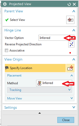

If I'm understanding the OP correctly, he needs a line at 95° to the X-axis of the drawing's CSYS. If that's the case, use Add Projected View and under the Hinge Line section of the dialog, change the Vector Option pulldown from Inferred to Defined. Under that pulldown will be the option to Specify Vector - click the smaller button (Vector Dialog) which brings up another dialog that allows you to define the vector. In this case we know you have a line that is exactly 5° and you want a vector (angle) perpendicular to that so using this Vector Dialog, we can change the top pulldown to At Angle to XC. Since we have the given 5°, we simply need to add 90° to that, so enter 95 in the Angle input and click OK or MB2. You will now be taken back to the Project View dialog and you should now see the Projected View dragging around with whatever preview you have set. In the Placement section of the dialog, make sure the Method pulldown is set to Hinge. You should now be able to drag the view out and drop it.

Put the two settings (below) to Inferred and notice if the new view will index in place (to the angle you want) when moving around the parent view before placing it, then click your mouse button set the view.
