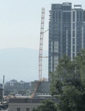

VANCOUVER -- The crane collapse that forced an area of downtown Kelowna, B.C., to be evacuated on Monday morning has left multiple people dead, according to authorities.
The accident, which damaged several buildings in the area of Bernard Avenue and St. Paul Street, has also prompted officials to declare a local state of emergency in the Okanagan city.
Witnesses described a chaotic scene in which workers tried to get out of harm's way as the crane was coming down.
Update:
VANCOUVER -- Mounties say at least four people have died as a result of a crane collapse in Kelowna, B.C., on Monday.
In a news conference the next day, Kelowna RCMP Insp. Adam MacIntosh said a fifth person is also believed to have died in the collapse, but his remains have not yet been recovered.
Of the four people known to have died, three died at the site and one was hospitalized, but did not survive.

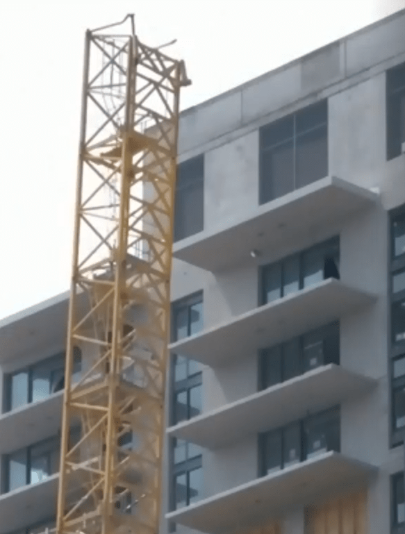

Any thoughts on what happened dik? Looks like the overall tower is a bit worse for wear but that could be due to the top falling off. Looks like the failure is localized to a truss near the roof line. Damaged member not caught during inspection maybe?

I'm not sure... but, I think they were dismantling it.
The crane was being dismounted, and it was the beam fell down.
There must have been a support at the top too against the building maybe it was pulled down with the beam. [ponder]
/A
Albert Einstein
When they removed the boom, the back section with the winches and counter weight may have pivoted down and hit the tower.

Some part of it came down between the tower and building and landed on the upper tie in knocking it down the tower before falling off and ending on the ground.
The article mentioned working scrambling to rescue the operator. Any pictures where the operator cab ended?
I didn't see a large enough portable crane to reach the top, so if they were disassembling it then I expect they were in the process of lowering it by removing tower sections. Possibly had it balanced wrong during the process?
