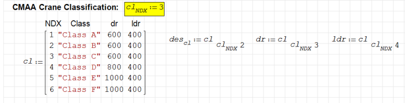

Is there a code related article for crane beam deflection? I've usually used L/480 or 1/2" maximum. I was wondering if this was quantified, somewhere. Thanks in advance.
From Chapter 14 of AISC DG 7:
Thanks, Gentlemen... I'll bump it up a tad... still keeping the 1/2"

From the top of my head, crane girders are limited to L/600 and 25 mm vertical deflection.
Lateral also L/600.
