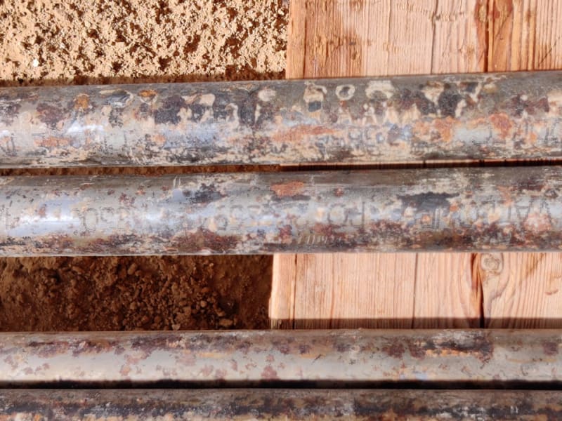

thank you for the help and for more details we have an older pipes in our factory we need to exploit it witch is important to know the date of manufacturing from the marking in pipe but we dont have the MTC for this quantity so my questions are
-where we can find the date of fabrication from the pipes marking ( is it written on pipe ?)

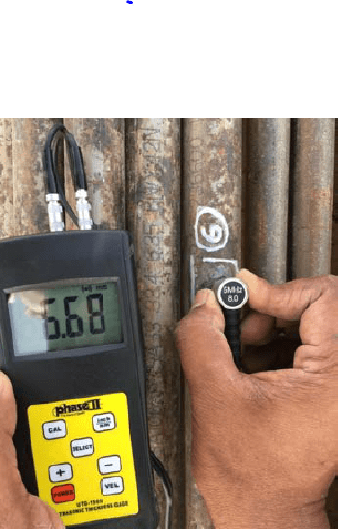

- only the measuring of thickness is useful or is there more test like ultrasonic if yes it s shall be done or not ) and finally refers photos in attachment ,
Regards
You can't find date of manufacture from anything other than the records of manufacture / data books.
A particular vendor may have a certain code, but it is vendor specific. Why are you interested? 50 year old pipes in good condition are better than 5 year old pipes with corrosion
UT thicknesses is good but is only spot location. But if the pits are not too deep then that can be used.
If the corrosion is only superficial (<1mm) then just clean them off with a blasting machine.
Deeper pits you need to assess.
you have to make thickness measurements and through Barlow formule, calculate the minimum thickness in conjunction with MAWP ( maximum allowable working pressure, after that you can ponderate if your pipe can work a little bit more or not.
luis
If you can find the heat number and the manufacturer, you can find when it was produced by the manufacturer. While you want to use the as yet unidentified pipe materials for some manufactured item, it depends on the item's end use and purchaser. It may well have to be scrapped or downgraded to something like fence posts or other use not requiring traceability to a required specification. This may be the price your company must pay for not properly warehousing its materials.
You can easily determine thickness and mechanical properties of the existing pipe by simple measurements and tensile testing of each piece if necessary.
I can just about make out a Purchase order number (PO xxxx) Surely you must have PO record numbers??
You might be permitted in some cases to use/reuse old pipe without original yield strength documentation, if you downgrade to 18,000 psi yield strength and calculate your allowable pressure accordingly (and if there is corrosion, by using B31G or similar methods as LittleInch mentioned). You might also be able to re-establish an allowable yield stress by doing specific numbers of tensile tests on specimens pulled from your pipes. SEE YOUR DESIGN CODE for what you are allowed to do with undocumented pipe.

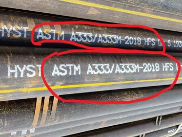

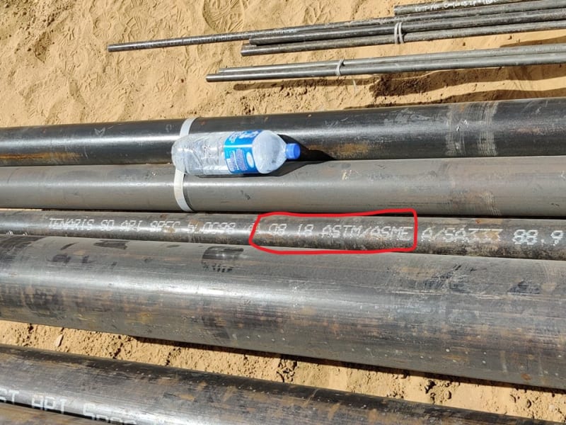

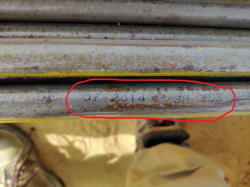

hi everyone
I appreciate all your responses and for go more deeply in the subject i will attached more photos showing a different markings in the pipe so my question is
to know if the different marking highlighted in the attached pipe pictures is related to the fabrication date of the pipes or the ASTM revision date.
