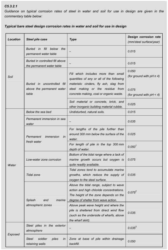

I think the corrugated pipe depth should be in the range of several feet, and the pile buried in the soil below the corrugated pipe is in submerged condition. The below snap from Pile Design and Construction Practice (Tomlinson ). The average corrosion rate should be in the range of 0.02 mm/year.

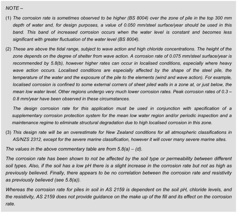

This might be of use as another data point, it's from the NZ steel code.

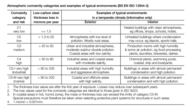

I did manage to find this table in BCSA that has a parallel table with FHWA's Steel Handbook. My thinking was to use category C4. While I don't have salinity in the water coming in, I likely have more dry/wet cycles than just atmospheric conditions.
My experience is that there are many corrosion tables so DOT's have their own. You should check with your client to see if they have a preference. If not recommend one.
For the piles, sounds like you are on the right path. Checking the required capacity assuming some loss of thickness due to corrosion against the demand. You might get lucky and the original designer added some sacrificial thickness.
