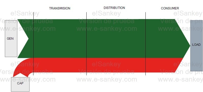

In a simple general case the load needs a certain amount of reactive energy, and you have to supply it one way or the other.
Location 1: Caps near generation side.
See that the reactive energy (red in the graph, green being active energy) will circulate all the way through the grid from generation to consumer, lowering the lines and transformers capacities and increasing the losses in every step of the way.

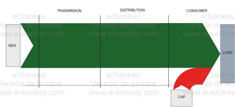

Location 2: Caps near the load.
Now the reactive energy is supplied locally and the rest of the grid can work more lightly (less losses) or supply more active power (with the same losses).
You usually compensate reactive energy as close to the reactive source as practical or cost-effective can be made.
With these images in mind you won't forget the basics ever again!
