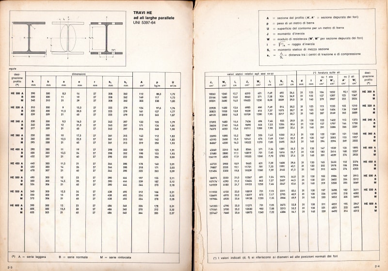

the old therminology was (and still I use it) : HE 600 A because there is also HE 600 B and also HE 600 M.
A serie means "light", B serie means "standard" , M serie means "strengthened" .
size 600 is the max standard size (from the steel mill). 900 is welded profile

-I have uploaded again the EURONORM 53-62 which is the basis for dimensions of HE sections..
-The latest available sections for HE beams have series of ( AA,A,B and M)..
- AFAIK, all manufacturers and the standard EURONORM 53-62 use the notation e.g. ( HE 900 AA, HE 900 A,HE 900 B and HE 900 M)..
