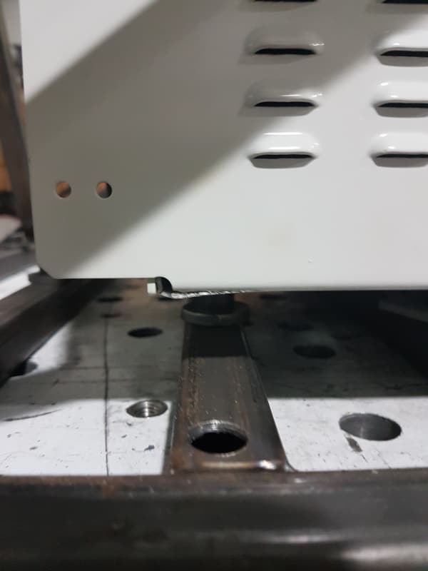

Hello all,
During recent testing of an electronic chassis, the corners at the floor are suffering cracking as show in attached photo.
Initially there was no corner relief in the design, which I changed to have corner relief. Picture attached also to show the area which is showing cracking. However even with the corner relief, cracking has occurred.
The failure is happening in the up/down axis of bump.
I am thinking of welding the seam fully to prevent this.

Try cutting off that little white square of sheet metal next to the tear. It is hitting the metal above during your test and acting as a crow bar to tear the sheet metal.
Compositepro,
That "white square" is actually the lower edge of a vertical flange which may be an entire wall panel on the side we can't see for the box wall we are facing in the photo view.
That flange should be attached to the forward wall, so that they can work together and mutually reinforce the corner in terms of both strength and stiffness.
Of course, the previous comments about tight bend radius also still stand...

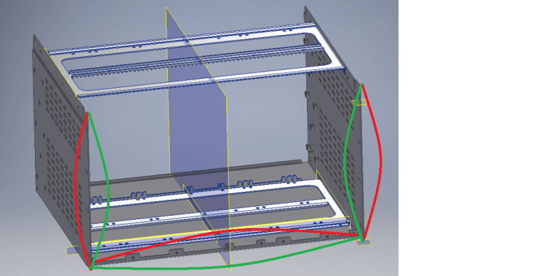

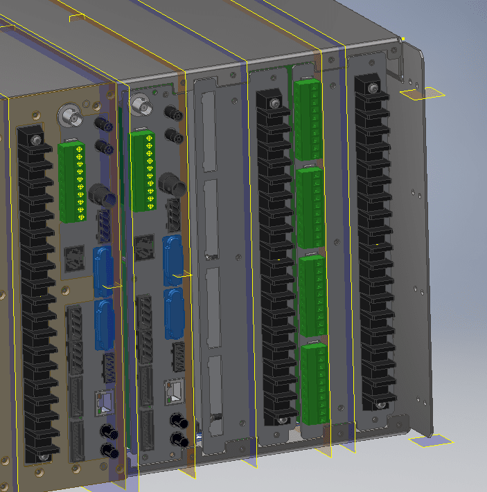

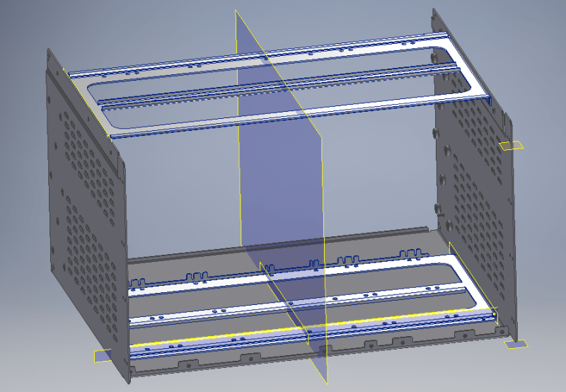

Hopefully this uploads ok, an image of the rear of the chassis from the 3D model. No roof or rear plates shown for clarity.
Front of chassis showing mounting within the Vibration table frame. Held at front only through use of 8off M6 bolts.
Seems pretty likely that your side and bottom panels are doing something like this:
Forget welding. The bend radius is too small for the material, which appears to be aluminum. If tempered, do the bends at T0 or T1 and let age to strength.Strength is not likely an issue here since it is just an enclosure.

Knowing more about the specifics - this is a frequent problem where there is an abrupt change in stiffness. It serves as a stress concentration and a place to initiate a crack. The usual answer is to add a doubler plate to stiffen the weaker item and transition the load from there to the stiffer part. The reason for the change in stiffness is the flange that has no matching structure, making it effectively infinitely more stiff than the bottom surface which has no material at that location. As it is, it is designed like a 'tear here' feature. If you've ever pulled a sheet of paper over the corner of a table to tear it, you've done what this is doing.
In other, similar situations, I have seen people add local structure which merely serves to move the discontinuity elsewhere, and with it, the cracking. It's best to get an FEA model that correctly represents the juncture to decrease the number of tests. I would start with a 90 degree bent bar about 2X thickness and 8:1 W:t ratio that extends 30t along each face and heavily spot welded or riveted to spread the load. I think that won't be the final answer but it's an analysis start.
Can you show the rear and roof plates? As @SparWeb mentions a couple of times above, I think that you need to look at how the floor is connected to the side walls. Is the rear plate connected via fasteners to *both* the floor and the wall? If the back wall is not connected to the side wall and the floor (assuming that the floor is where the electronic cards are mounted), that may be the cause of the cracking.
Engineering is not the science behind building. It is the science behind not building.
Hi Tex,
Sorry for the delay in reply. Rear plate is connected to roof and U-shaped chassis base using screw fasteners.
Due to time constraint on a test slot which was already booked, I have introduced L-Shaped stiffening brackets in internal corners. I will provide an update when test complete to see if this is sufficient to stop floor tearing.
